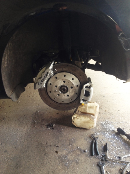

                                                      Brakesystem is now 95% updated.
                                                      Front brakes were already few months ago updated to brembo 8-spot calipers. As im using 20`` wheels, rears were looking ridiculously small.
                                                      Front:
                                                      Rs6 C5 8-spot calipers
                                                      New brakepads
                                                      New 365x34 mm brakedisc
                                                      HEL performance brakelines
                                                      NOW rears:
                                                      Audi RS6 c6 V10 rear brakecaliper frames + A5 electrical handbrake motor + new brakepads
                                                      Porche cayanne Turbo S 955 facelift 4-sport brembo brake calipers + new brakepads.
                                                      Audi RS6 c6 V10 brakedisc 356x28mm
                                                      Audi A5 3.0TDI front brakehoses
                                                      Custom brakecaliper carriers
                                                      Some explenation.
                                                      I was really motivated when i got staff, but actually non of those things were even close to bolt-ON fit.
                                                      I made custom carriers for both calipers separately and from 15mm steel. It was quite a challange to make correct shape and it was hard to find boltinglocations for M12 bolts.
                                                      Ofcourse disc offset was wrong also and had to put 25mm aluminium flange between disc and hub. Luckily i managed to put same wheel flange what i was using between wheel and brakedisc before. Now wheel offset remained the same which is really good. Also wheelbolts lenght remained.
                                                      After 10h and alot of swearing flanges were ready for both side.
                                                      During same night, i managed to clean calipers abit, painted them, added same style brembo logo like front have and lacqued it over to maintain good look after years.
                                                      Through whole project, i liked porche brakepads the most.
                                                        Rs6 brakecaliper was meant to be invalid from the first day. Oil system i made blind and i create small vacum inside + i filled it with some oil for cylynder health. There i replaced nipple with polt.
                                                        RS6 handbrake motor plug didnt fit with A5 body side electrical system, but luckily A5 motor was going 1:1 to Rs6 caliper.
                                                        Finally all things were together and working, gaps were normal and everything was good to go. All nuts fixed with nylon stopsystem or threadlock glue.
                                                        I calibrated and adjusted engine tolerances with computer. Its working like a charm now.
                                                        Porche brakes were working also after air was out from system.
                                                        Testdrive was starting smoothly and ended with heavy braking. I wanted to see how this mod will behave in normal traffic and during extreme conditions.
                                                        Now all works. Nothing is stuck and no problems. Just brakes needs to have some RUN In time.
                                                        I could say thats not bad result at all. Its braking like crazy mothafucka now. Its really cool.
